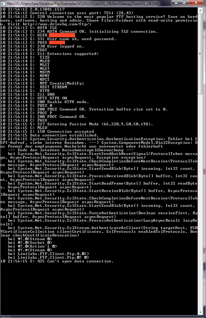

I want to create a windows executable. It shall be a FTP Program.
I tested my program and it worked nicely. Even the free FTP webspace worked. Now i recognized a problem: My login data can be read out by some software that reads the outgoing FTP commands. Thats why i decided that i need SSL - Security.
Filezilla and professional ftp programs work nicely with SSL. No problem with connecting. Now that i changed my program using SSL it refuses to connect. I think its a certification problem. Filezilla and other professional FTP tools show a window that asks whether i trust this certificate. I dunno how to implement this. I write in Visual basic. Net.
Is there any *.cer or *.pfx file offered by drivehq? I dunno what to do, as this problem only arised after i tried to implement SSL.

here is some output:

Subject: Re:.cer or .pfx files. SSL Certification for selfmade ftp program
DriveHQ supports FTP over SSL, both implicit and explicit.
I think this is the problem. You need to implement this feature like FileZilla or other popular FTP client, or you might be able to work around by setting an option to ignore certificate error.
DriveHQ FTP Server uses a wild card certificate. A wildcard certificate can match host names like *.drivehq.com. DriveHQ has two FTP sites ftp.drivehq.com and proftp.drivehq.com both using the same wildcard certificate.
